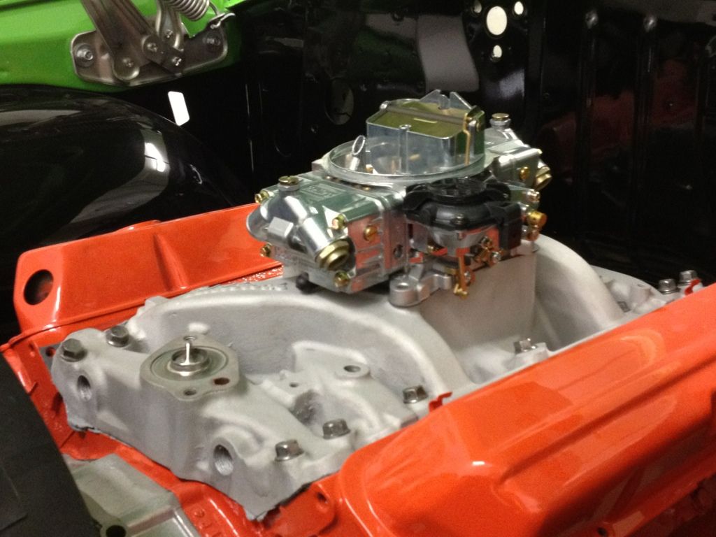

    Well tonight I gots the manifold bolted up, which was a bit sketchy at times.
    Does anyone know what size bolts I would need to bolt the carburetor to the manifold? It's a elderbrock performer. And also what bolts for the thermostat? All of which are completely non existant.
    More questions
    what way round for the carburetor?
    And should I run with a spacer?
    Why wouldn't you run with a blank thermostat housing?

    Looking good, carby goes the other way round.
    Cheers Mark

    I suppose you need the the ports on the thermostat housing for the heater hoses. Looking good Mook!
    On the standard manifold/carby they used two studs and two bolts.Mainly cause you can't fit bolts on the carby. Check that bolts will work and that you don't need studs and nuts for that carb.
  9. #139
    Ok get it for the manifold bolts/studs. I'll check for clearance on the carb.
    Can I run the heater pipes from the water pump and have a blank thermostat housing?
    Or will it always be hot in the cab?

    Quote Originally Posted by mook View Post
    I couldn't see why you couldn't rig it like that. My HJ 308 (original manifold) has an outlet on the thermostat housing that only attaches back onto the manifold under the choke. My heater hoses (both) run from the water pump housing to the (A/C) heater box. I would suggest that the hotest water for the heater would be from the thermostat housing as the water exits the engine in that direction towards the radiator.
    Regards,
    Dave
