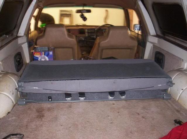

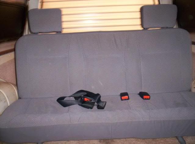

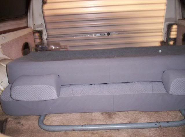

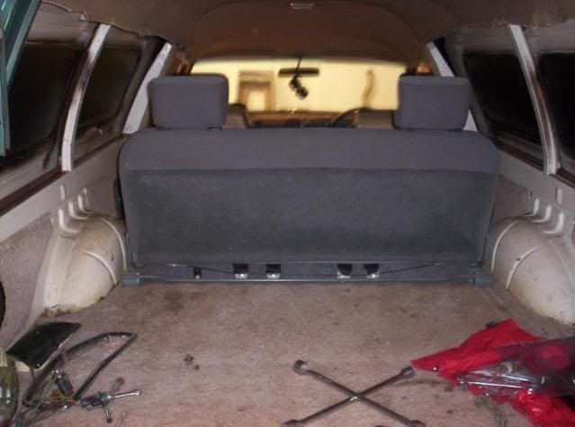

    agro has a nice seat setup in the back of his van..
    I was told that it was out of a TR Magna, But it has been in there when i got it. :D

    It was done in NSW and fortunatly my HZ has side windows anyway. :D
