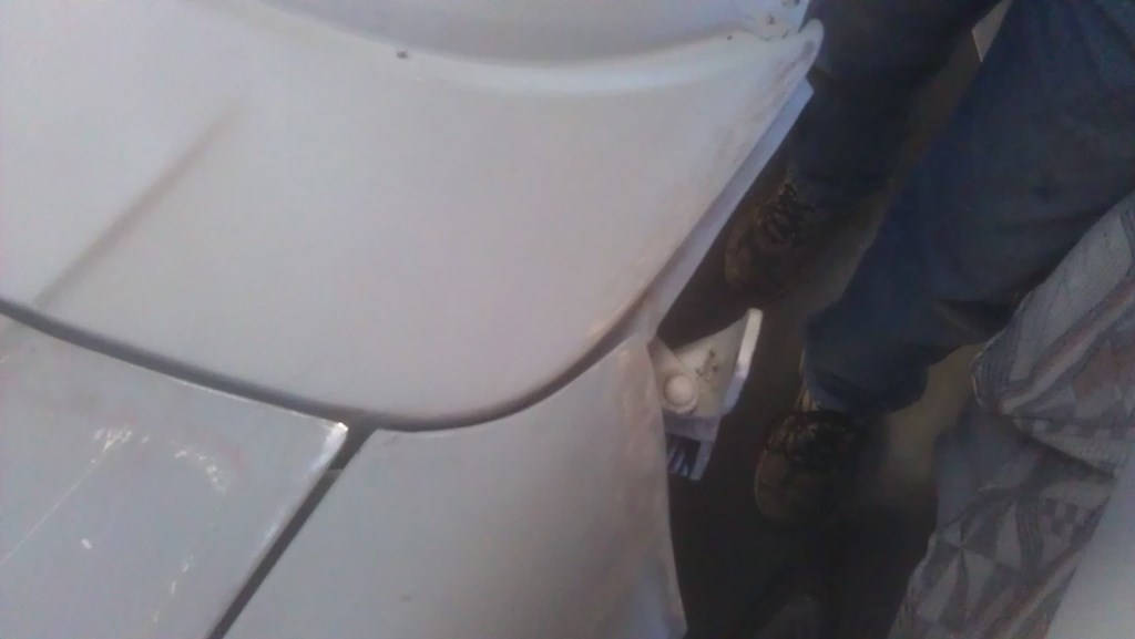

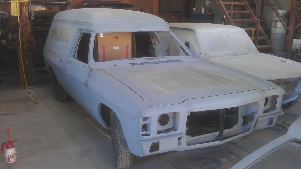

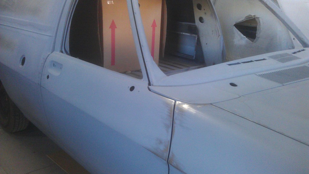

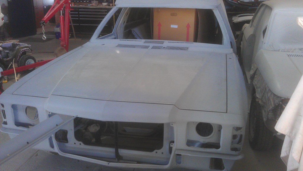

    Panels lined up, some sanding and rubbing back - pretty quite in the panel shop at the moment.
    Guard and cowel panel needs a bit or tweaking.

    The genuine guards have already been fitted, these photos are about a year old and they started fitting these because they thought we were going to weld ins!

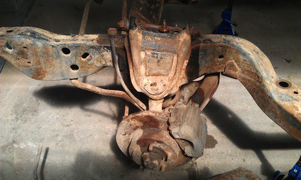

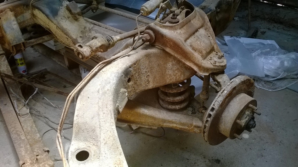

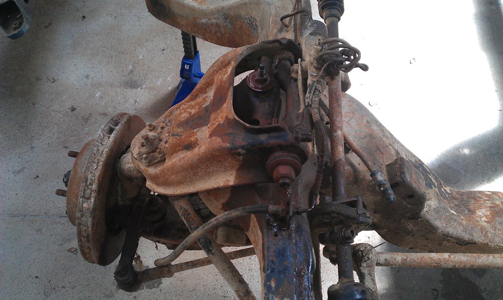

    So another year nearly gone and life just gets in the way for restoration.
    I hope to get the chassis ready for blasting before Christmas (this year!) in the only few weeks that I have off for the remainder of the year.
    A lot of work to do and I don't know where to start.
  7. #187

  9. #189
    Quote Originally Posted by HJRAY View Post
    Where would you look for the chasis numbers...?
    Same place just hard to find with all the mud and rust build up.
    Top chassis rail next to the steering box.
    I dont think thats quite as much work as it looks Blocker, it looks like a heap of effort, but not neccecarily,
    Looking at the pics, you probably dont actually need to blast it , a blue 3m flap disc on an angle ginder will bring that up to shiny steel all over in a half days work easy! Another day in paint prep detail and you'll save yourself all that time and hassle and transport and cash to get it to the blasters and back and be ready for paint!
    If you really were being serious about not knowing where to start on it (hard to tell in forums sometimes), if you use a product like Penetrene on all the threads, you should be able strip the running gear off the chassis in a day or two fairly easy, I'll message ya.
