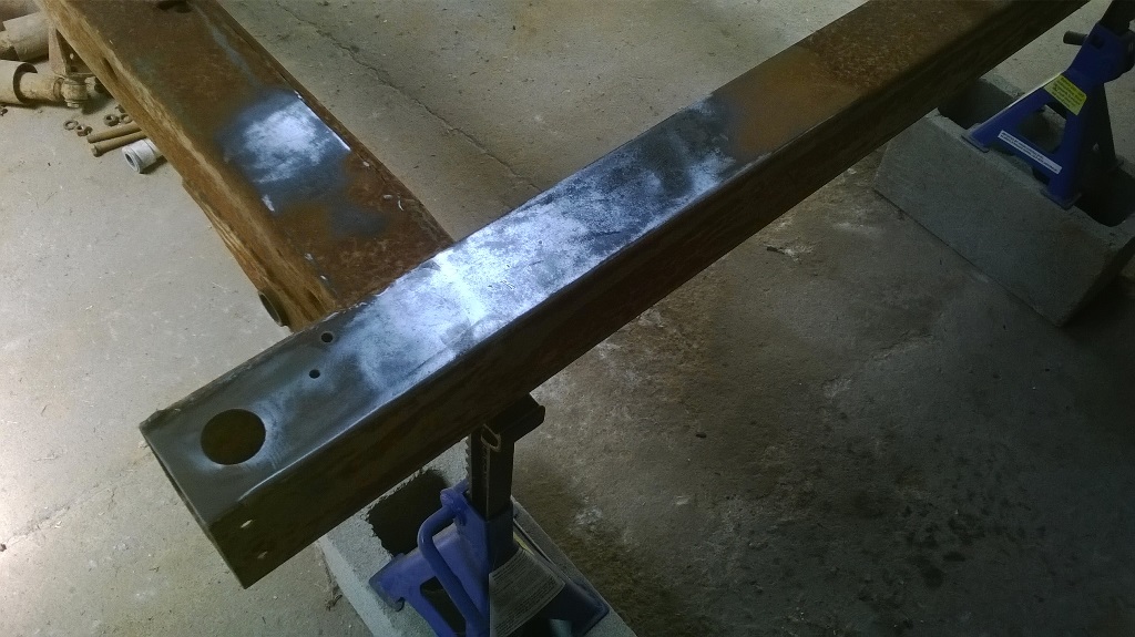

    Thanks Dave,
    I flapped and flapped only for about 5 minutes to get an idea of what would be required. The results speak for themselves!

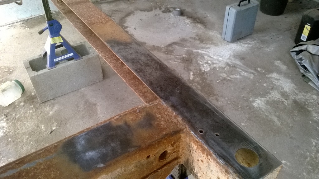

    So the chassis is off to the blasters, and while striping the front end I noticed that the front rails look a little bent - anyone care to comment?
  7. #197
    It does look like it may have had a little knock, mine aren't pushed about like that. IIRC there are some chassis drop test specs in the HQ supplements somewhere. Since moving last year I'm yet to lay my hands on my books as, like everything else of value it is in storage. I think it was in the commercial supplement.
  8. #198
    Picton NSW
    1,129
    Hi Blocker, did you strip all the parts off the chassis? Question being, did the front panel/bumpers attach okay? Looks like a gentle massage with a lump hammer on the ends would be all that's required if anything.
  9. #199
    Yes everything stiped off ok, and I agree just a bit of massaging when the new front end and rods go in.
  10. #200
    I'm wondering if it has already been on a rack and that a gentle belt was needed (hence the ends of the chassis)?
    Might be straight enough already?
