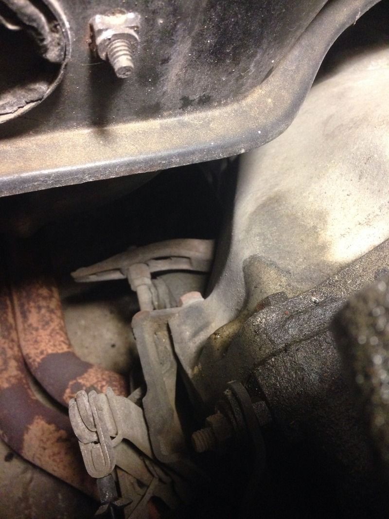

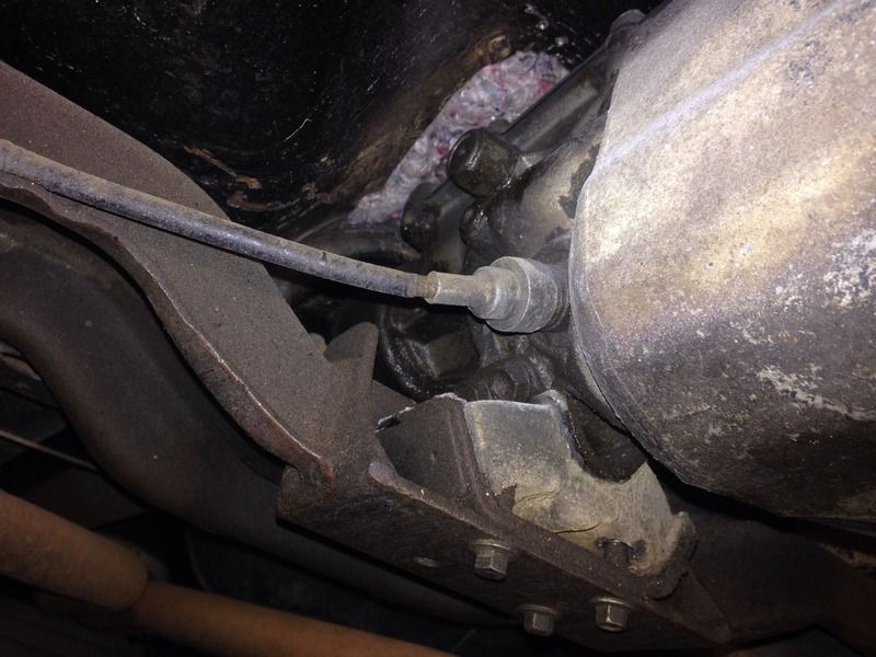

    Hey guys this is the 5 sped gearbox in my HZ, Ive always thought it was an old supra 5 speed jobby but someone tried to tell me its a commodore box. Quite frankly I dont really know.. But I should shouldnt I!
    Its a 5 speed, and has the push clutch mechanism ala the awesome HZ rat trap setup....
    Bit hard to tell from those pictures but the gearbox mount looks very much Toyota.
    Clutch set can be all Holden. The Bellhousing is aftermarket Dellow/CRS etc. So Hydraulic or Rat Trap can be set up.
    Got a supra box in my garage on the floor atm looks very close to that

    could be a philipino box out of VH commy, has it got a big 5 on the side of it? Im presumining its a 6cylinder
    Looks like a V8 to me.
    Looks like a W55 Hilux box to me (often called a Supra 5sp). The bellhousing will say what it is somewhere - looks like a Dellow bellhousing by the longer bottom bolts.
    Celica alloy 5-speed. Plus I have a crossmember here out of a Torana that has been modified for a Celica box and it looks almost exactly the same.
    I have what looks like the same box as yours with a Dellow V8 bellhousing and was told it was Celica.

    That explains it then, because ive had this engine and box in 2 other HQ vans too before I put it in the HZ, and its always popped into the console in exactly the right spot.
    I am actually contemplating putting my 304 EFI and T5 into the sandman (more about that later), and taking this celica 5 speed and 308 out and putting it in the Torana. Down the track...
    Im not sure how the dellow housing bolts compare to the M20 setup but I was hoping I might be able to bolt the Torana V8 rat trap to this....

    You can have it if you want it, I'll sell you the box too and then you'll have a spare. PM me....
    Torana V8 rat-trap relies on the bellhousing rear bolts to attach, yours looks like a Dellow so has longer bolts and will not fit without modification.
    I just looked again and you can see where the HX style rat-trap has been modded to suit the longer bolts. That Holden setup should work in your Torana with the Torana pedal and cable but may not clear the extractors.
