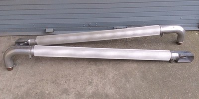

    https://i.ebayimg.com/images/g/~qcAA...goF/s-l400.jpg
    I got a set of these from America.
    These are 'Thrush" brand.

    The side pipes are 60 inch patriot side pipes imported by rocket industries and I think some proformance mob from queensland and to my knowedge they are legal on vehicals pre 1982 as long as they exhaust 400mm behind the rear door and have correct ground clearance (beer can 100mm I think) so really only legal to vans Utes and coupes

    As far as I know the exit measurement is behind the last opening passenger window. You also must comply with ride height rules. So if you are meant to have 100mm clearance it applies to every part of the car.
    Show Tubes/Lake Pipes are the best looking in my opinion. But then again if they are 4" off the ground at their lowest point they look ridiculous. Each state will have their own rules etc. Whatever floats your boat!
