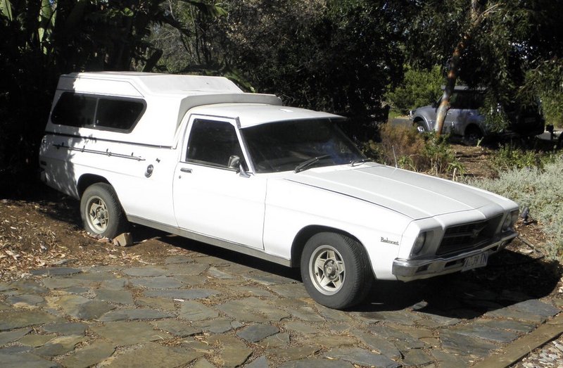

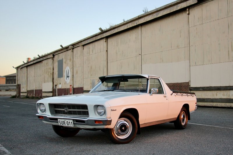

    This is the old girl in question...
    What a pearler

    Thanks mate. Despite being very chalky, the old paint polished up quite nicely.
    This is how it was found the day I picked her up (as found, where found before going into the trailer). Despite sitting for years, she started, drove out to the street and onto the trailer unaided).

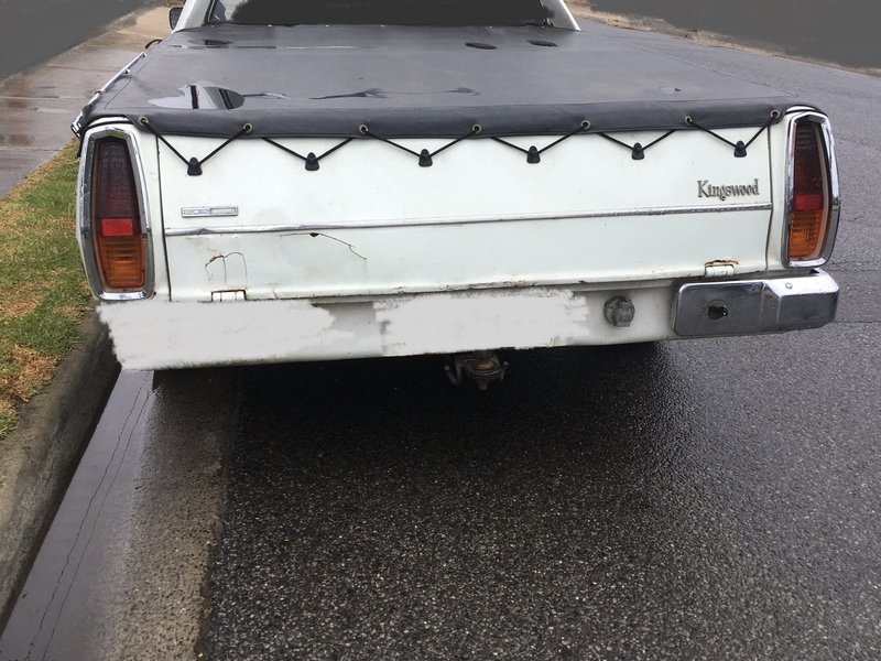

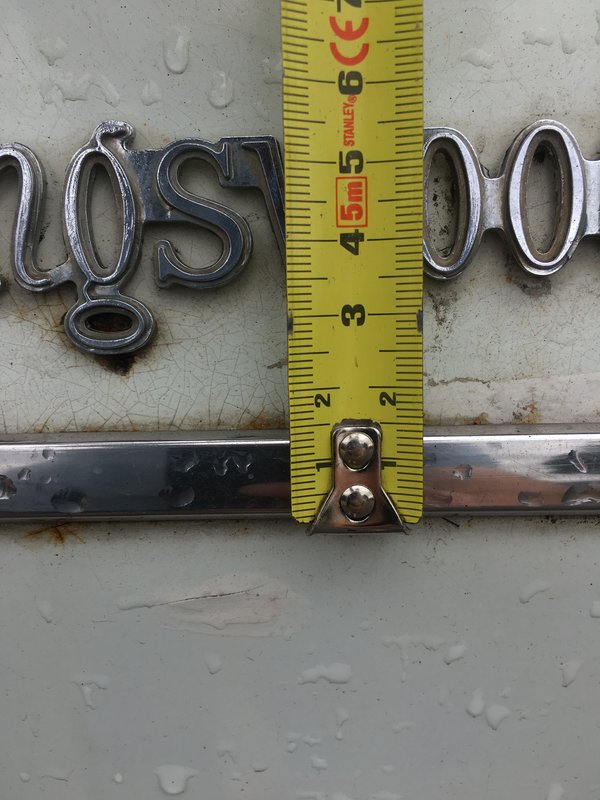

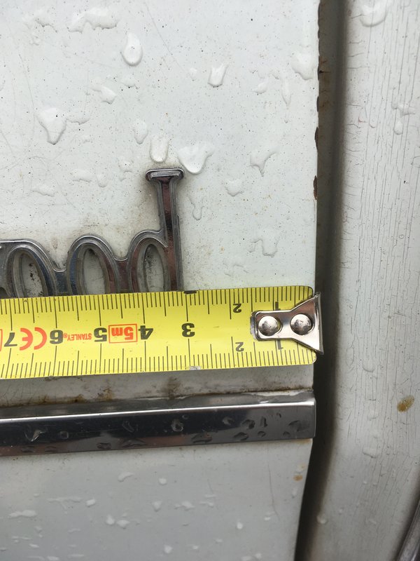

    Well, Murphy’s Law strikes again... I drove past this HQ ute parked on the side of the road yesterday so did a lap round the block and came back. I spent probably 6 months trying to solve this for myself before asking on the forum
    It’s a Kingswood but I assume that the Holden would have used the same mounting holes for both Belmont and Kingswood.
    Hopefully this helps you Innuendo, and also others in the future.
    The ‘upright’ of the ‘d’ appears to be 30mm from the right hand edge of the tailgate.
    Bottom edge of the silver strip lines up with the tailgate crease line. Look like the bottom of the font is 34-35mm above the crease line.

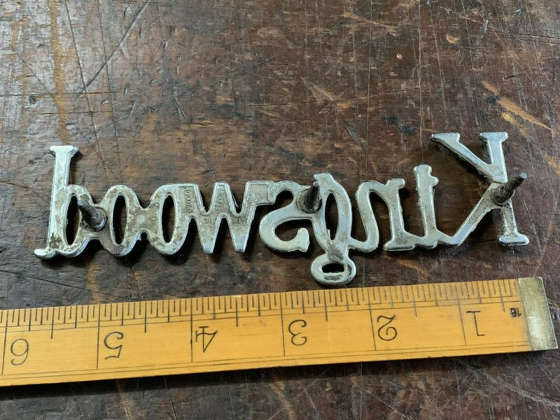

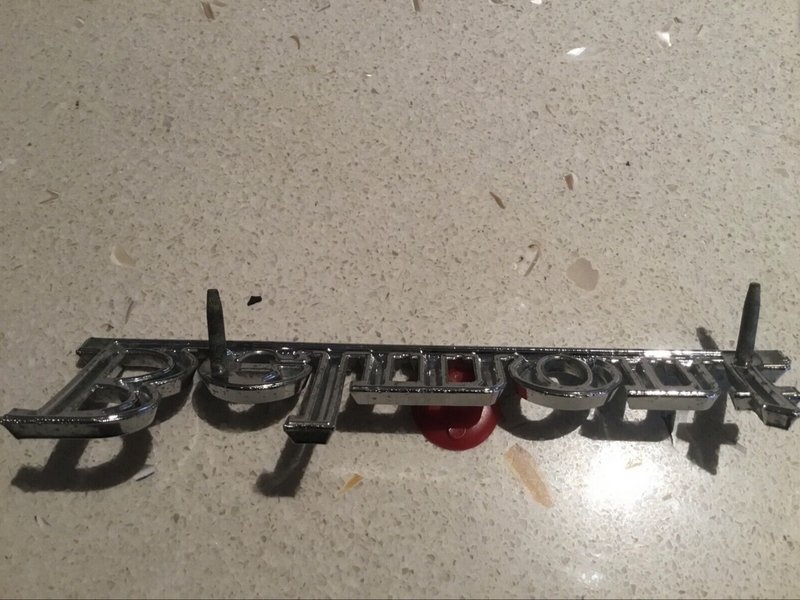

    From memory Belmont badges have 2 pins while Kingswood ones have 3 pins, that said I'm sure the badge positioning would be very similar in terms of the measurements to edge of tailgate etc.
    P Plater
    Jan 2016
    Adelaide
    61
    Quote Originally Posted by AN5590 View Post
    AN5590, a quick search of second hand badges on eBay confirms you are right!
