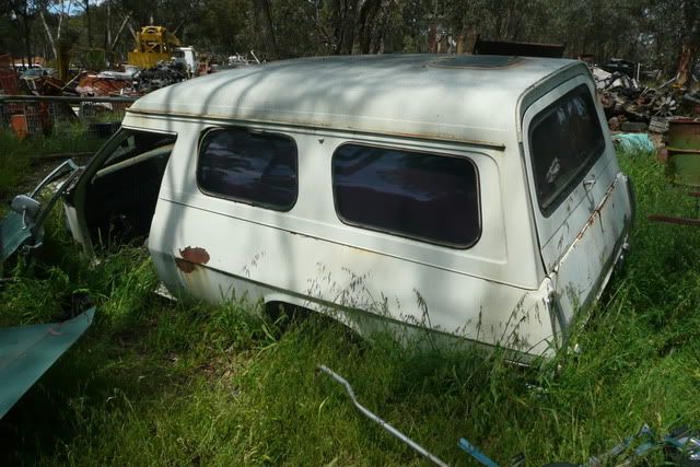

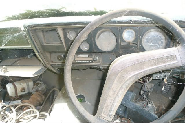

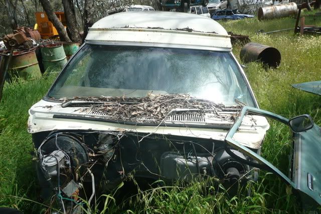

    Thanks everyone for you help and knowledge. Made an offer today and will pick it up in a fortnight. Very Happy
    And here she is in her glory.
    Looks like the original Chamois paint from the pics ... and original dash fascia too... good score Rookie
    Chamois is one of the rarest of HJ Sandman colours too.
