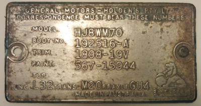

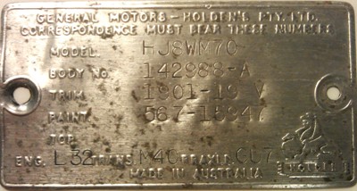

HJ Identification Plates Explained
Before detailing the HJ plates I'd like to point out an interesting or trivial fact regarding the HJ plates and the Adelaide assembly plant
At some stage during HJ production the Adelaide plant seemed to be the last assembly plant to have updated their Body Identification Plate stamping tool, the early plates were reverse stamped and the later models were embossed.
As an example two Body Identification plates are included as a guide to the difference between an early and later HJ Adelaide built vans.
hj plates
The first plate is a plate from a 2/75 plate - you will notice the reverse stamp unique to the Adelaide plant at the time, while other plants used embossed stamping, this is nothing more than trivial information rather than practical data.
The second Adelaide plate from 5/76 shows the common and standardized layout for the HJ series plates and is negative stamped giving a clearer picture of the details and not subject to weathering and fading as much as the earlier version. Once again there is no technical difference for the stamping style, it has been suggested that Holden at Elizabeth were the last to update their stamp tools compared to other plants.
hj plates
Body Identification Plate Breakdown
The Body Identification Plate has five significant lines relevant to the Holden Sandman which we will explain from the above plate as an example line by line.

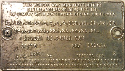

Compliance Plate Breakdown
The Compliance Plate (ADR Plate) has four sections and two important descriptors relevant to the Holden Sandman.
GVW
  • Gross Vehicle Weight - This is significant in determining a genuine Sandman and for the HJ will be below
    • 1950kg - V8 Panel van
    • 1860kg - V8 or 6cyl for Ute
    • 2200kg - if built between before middle 1975 because Holden did not introduce the derated GVW until later in the HJ series.
Seat Cap
  • To even be in contention as a possible genuine Sandman it must have 2 seat capacity - not 3. We have come across one plate that had a 2 stamped over a 3 but the Body ID Plate was marked with XX7 so doubt was removed.  This plate was known as the Monday shift Sandman and is obviously a mistake and a rare one at that!
Date
  • Indicates the build completion date, very simple.
Chassis Number
  • These numbers will identify that the body matches the chassis number. The chassis number is located on the top of the front chassis rail next to the steering box if the chassis has a 'P' preceding the numbers. This would be a Police stamp to indicate the chassis has been damaged, stolen or mismatched at some stage. Each State in Australia has a different method in police stamping so check with your local authorities.

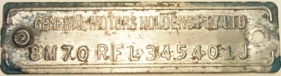

Vehicle Identification Number (VIN)
The VIN is the unique identification number for the car and is recorded Nationally as the Identification of the car. There is nothing on this plate that will identify it as a genuine Sandman or not, however the details are here on how to decode the letters and numbers.
Example 8M70RFL345401J
  • 8 - GM Holden Australia
  • M - Commercial vehicle or N for Kingswood
  • 70 - Panelvan (80 for Ute)
  • R - Engine Type
    • L - 3.3lt (202 6cyl)
    • R - 4.2lt (V8 253)
    • T - 5.0lt (V8 308)
  • F - Model Year
    • D - 1974
    • E - 1975
    • F - 1976
    • G - 1977
    • H - 1978
  • L3 - Assembly Plant
    • H1-H4 - Acacia Ridge (Brisbane)
    • H5-H9 - Pagewood (Sydney)
    • J1-J9 - Dandenong (Melbourne)
    • L1-L5 - Elizabeth (Adelaide)
  • 45401 - PSN which is the unique serial number.
  • J - Series Code
    • Q - HQ
    • J - HJ
    • X - HX
    • Z - HZ
